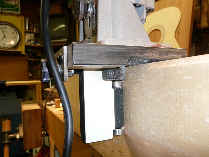

These are pix Hesh sent me. He'll have to elaborate
PostPosted: Sun Apr 15, 2007 2:43 am

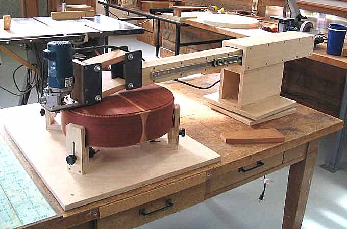

To let you know Hesh has moved away from that jig and is now using a Williams/Fleischman style jig.

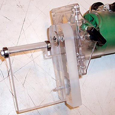

I made one similar to the Guitar Jigs, Taylor, Larrivee binding jig. Take a look here for one that Roy Ott made based on mine. He added some cool features that I want to add at some point too.
The pro's and cons are unique for each jig.
The Williams/Fleischman jig is larger, requiring more storage space and space to use it but because you are moving the cutter and not the guitar it's probably considered the easiest to use.

The jig that I built is very small, doesn't take up much room for storage, doesn't require more than one bit but......when your cutting the channel, your working blind in that you can't see the area being cut. You get use to this but it does take some practice.

over the years i've built and used a number of binding routing jigs, both the sort which index off the sides, and both the common types which index off the top, that offered by lmi and the williams design( look in the jigs and fixtures section above). to me the jigs which index off the top are preferable because it is much easier to maintain a uniform channel, but they do have the disadvantage of requiring more space for storage and use.
of the two common top indexing jigs, i prefer the williams type despite it taking a bit more time and material to build. for me, it is much easier running the router on the instrument than having to move the instrument under the router, especially when one takes into account the need to route down hill to minimise the risk of chipout. also takes a bit less space to use, but occupies a bit more in storage when not in use.
both do a good job.

I shall making a Williams jig as I feel it`s the best jig for the job. I just bought the hardware needed here in the UK from my local B&Q store. For UK OLFers here are the prices.
Router cutter - ?12.95
Draw slides - ?12.98
Television swivel - ?7.98
I shall be turning some nylon bushes on my mini lathe for the router cutter. I`ll make them as needed. Two I need first will be one for a .020" and one for a .110" rebate. Notice the router cutter has a shear cut angle. Should cut down the possibility of tearout.

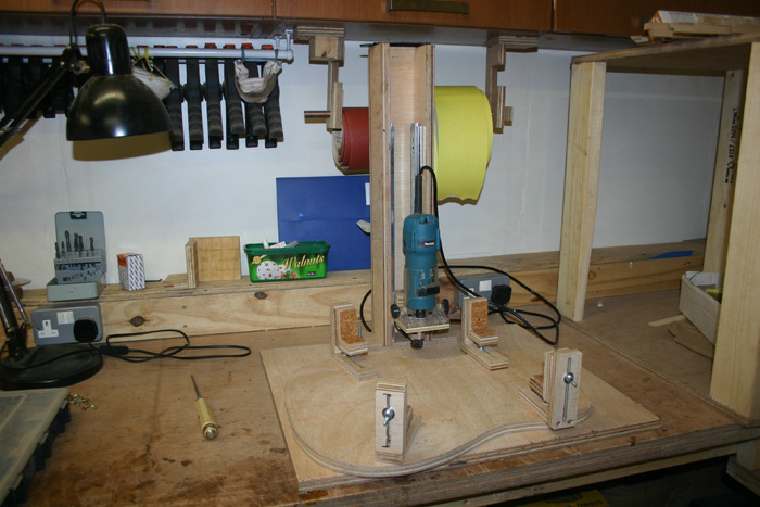

PostPosted: Mon Apr 16, 2007 1:45 pm
Posts: 744

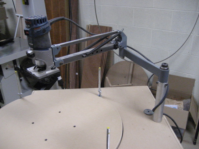

Here is just a different approach for a compact binding jig. The basic jig is a "Balance Arm" I found used at a industrial surplus warehouse for $30. I have seen similar items on Ebay. I had to adapt the end to fit my Bosch Colt. With a little creativity I am sure this could be built from hardwood and standard hardware. In this picture I mounted the jig to the back of my dish sander so it can be swiveled out of the way when not in use.
Good Luck!

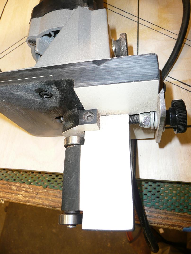

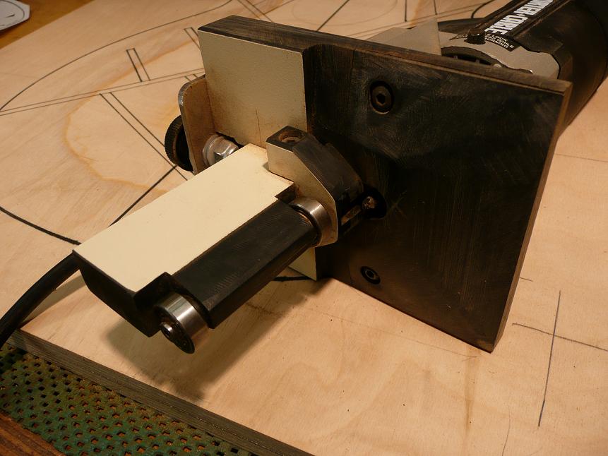

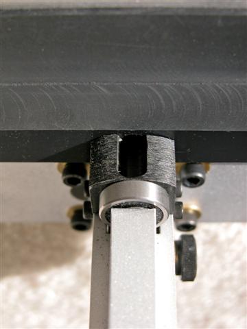

Hesh,
I built a jig out of phenolic that looks just like yours.  I didn't have any problem with tilting it into the guitar, the geometry of the shoe prevents that from happening - at least with mine.  I use a down cut 1/4" spiral carbide and it did a very nice job.  If I wasn't so lazy I'd go out to the shop and take a picture.  I used fine threads on the lead screw so the adjusment is very precise, indexable and repeatable.

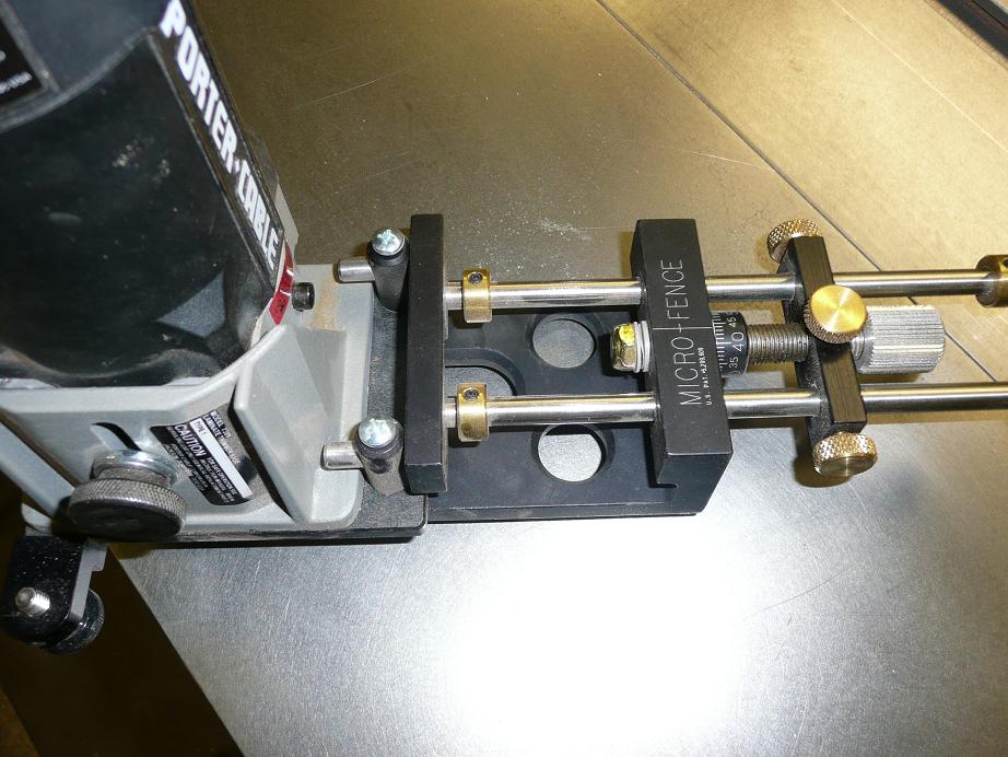

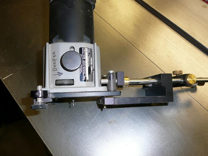

Hesh, here's some pics of my home made jig.
And while were at it a couple shots of the Micro Fence jig for cutting rosettes and such.  This is a wonderful little tool.  Grizzly sells down cut spirals as small as .023", which allows you to cut in VERY small purfling lines at the rosettee.
